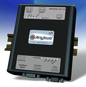

Anybus-X-gateways1
These gateways can also copy I/O data between Profinet IRT and other industrial networks. I/O sizes and other gateway configurations can be configured utilizing a Windows-based terminal interface, eliminating the need for any programming.
These new gateways also deliver a baud rate of 100Mbit/s (full duplex). They can also utilize two SC-RJ connectors (fiber optic), or two RJ-45 connectors (copper), as well as supporting installations either ring or in-line topologies. In addition, they also feature an integrated two-port IRT switch, eliminating the need for external switches.
