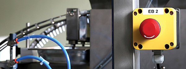

4. Myth: The emergency stop is a safety feature
From IEC60204-1 (section 9.2.5.4.1) Safety of Machinery – Electrical equipment of machines: “Emergency stop and emergency switching off are complementary protective measures that are not primary means of risk reduction for hazards (for example trapping, entanglement, electric shock or burn) at a machine (see ISO 12100) …”
Kollmorgen-safety-feature-button
Controlling sway can speed up positioning when handling suspended loads.
Many standards, including NFPA 79 of the U.S. National Electrical Code, reference the need for an emergency stop. IEC60204-1 and NFPA 79 are generally aligned in the area of emergency-stop requirements. But all machines pose risks, and an emergency stop doesn’t make a machine safe. Functional safety aims to reduce the operational risks associated with machines. Emergency stops are designed for unplanned occurrences. Modern safety standards spur safety systems that respond properly without the need for emergency intervention.
So, OEMs and integrators often ask: What is the required safety level of the emergency-stop function? The answer depends on the residual hazard left in the machine.
