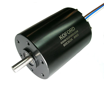

Koford Engineering LLC has introduced a new 48v 2-pole  60mm diameter slotless sensorless brushless motor with a 512 watt continuous output at 15,792 rpm at 48 volts.  The peak motor efficiency is 93%.
The 24 volt version outputs 256 watts at 7,560 rpm and has a peak efficiency of 92%.  The motor weighs 1.00 kg. These motors are also offered with hall sensor and also the option of a temperature sensor.
The motor is totally enclosed and made of corrosion resistant materials.  The slotless design offers exceptional efficiency and  power density with zero cog and linear torque behavior which is suitble for servo applications.
