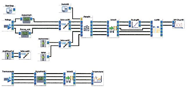

Accompanying images show the test equipment and The test hardware table lists a few of its details. The software used, DASYlab, is a graphical programming language. It is programmed by placing block diagrams representing data collection operations on a screen and connecting them with “wires” to control data flow. In the system used here, processed data is written to disk in a tab-separated format suitable for further analysis using Microsoft Excel.

Programming the data collection: The DASYlab block diagram provides an example programming screen. Each block represents an operation on the data such as collecting, scaling, saving to disk, and displaying. This programming method is faster than writing code. For example, the voltage output from the torque transducer, encoder, and thermocouples was connected to the electronic interface box. This box has a built in reference junction for the thermocouples. The device also has digital and analog outputs but these were not used. The interface box scans its inputs and converts from analog to digital values. These are passed to the computer through a USB connection at about 1Hz. This is relatively slow for data acquisition, but more than adequate for these quasistatic tests.
The sample screen shows how DASYlab software is programmed, by running virtual wires from sensors to instruments.

In the DASYlab program, the first box is an input box that “talks” to the hardware and places the input values on its outputs in digital form. Typically this is a special module that works only with particular hardware. Most other boxes do not depend on the type of hardware in the system. The other boxes used are numerical displays, graphical displays, and output boxes to record the data on disk. These boxes have corresponding components on a display screen. This screen can be a virtual instrument, that is, it can look like instruments such as voltmeters, oscilloscopes, and chart recorders. For this test the program converts the inputs to engineering units and displays the values several ways. Digital displays show the current numerical values of inputs.
Another display, an XY-plot, shows rotation on the Y-axis and torque on the X-axis. This feedback gives a preview of results. It can save much time because if something is wrong, such as a broken wire or failed thermocouple, it quickly becomes apparent. The test can be stopped, the problem corrected, and the test resumed. A problem that goes undetected until the data is analyzed wastes the entire test period.
A disadvantage of DASYlab is that this program had to be written with the computer attached to the interface hardware. It would be a great advantage to write the program sitting in front of a desktop computer rather than working in the test area using a laptop.
