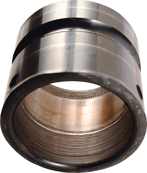

bearing-scratching-on-inner-ring
Scratching, gouging and general wear in the bore of an inner ring and on the OD of a shaft are indications of loss of lock, this can be caused by improper tightening of the locking mechanism.
