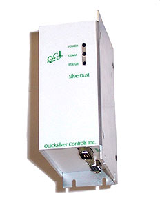

QuickSilver Controls, Inc. introduces a low cost CiA DSP 402 CANopen servo motor controller. The SilverDust IGK is a stand alone, single axis controller that includes serial communications (RS-232, RS-485), CANopen and 7 I/O. CANopen can be configured for peer-to-peer, master or slave which allows the controllers to share I/O with other CANopen controllers and 3rd party CANopen devices (i.e. I/O blocks, encoders,…).
CiA DSP 402 refers to CAN in Automation (CiA) Draft Standard Proposal (DSP) 402 CANopen Drives and Motion Control Device Profile. This profile defines such functions as start-up and homing techniques as well as motion profiles. A host controller, for example a PLC, supporting CiA DSP 402 could command multiple CiA DSP 402 motor controllers from multiple vendors. CiA DSP 402 runs on top of CANopen (CiA DSP 302 v4.0).
The RS-232/RS-485 serial network runs in parallel to CANopen for supervisory control from a host (i.e. PC, PLC, HMI..).
The IGK is designed to servo QuickSilver’s NEMA 17 and NEMA 23 frame I-Grade servo motors. 7 bi-directional I/O can be broken out using one of our QCI’s basic breakouts (QCI-BO-B, QCI-BO-B1, QCI-BO-B1A) or, if 24V I/O is needed, using the QCI-BO-B52.
