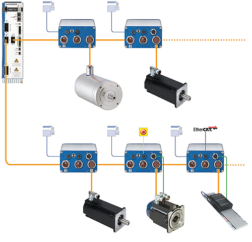

distributed-servo-drive-architecture
The layout is a distributed servo drive architecture with AKD-N servo drives, different motor types and single-cable connection technology.
However, separating the motor and drive at this point prevents the inherent design-related derating. This solution provides the basis for smaller motors in combination with better energy efficiency. In addition, integrated combinations are usually focused on a single motor type, limiting flexibility in the machine design. In contrast, any brushless motor type can be connected to the decentralized servo drive.
