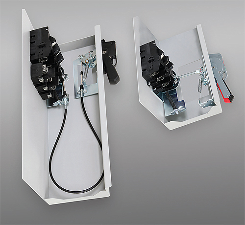

Allen-Bradley-1494U-visible-blade-disconnect-switch
Disconnect switches, including the Allen-Bradley 1494U visible-blade disconnect switch, isolate motors, motor controllers and other loads from supply circuit
