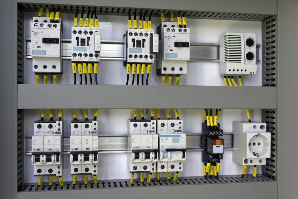

DIN rail provides a standard way of organizing and mounting breakers, terminal blocks, relays, drives, and other electric and electronic components. This is an industrial control panel with various power and control components mounted on large-format DIN rail.
