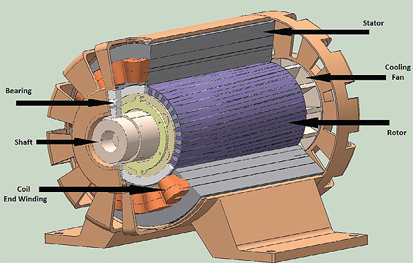

Analyzing an Induction Motor
The torque-producing materials found in IMs are copper wires wrapped around stator laminations and rotor laminations, with insulated copper or aluminum bars inserted in the rotor laminations. A voltage in the motor windings creates current flow that produces a magnetic field. The field flows through the rotor at the same point. The motor controller switches the voltage from one winding to the next winding, causing the magnetic field to change location, and the rotor follows the magnetic field.
Based on the specifications, FEA simulations showed that an IM optimized for vehicle duty operation had a diameter of 290 mm and a length of 234.4 mm. Given those dimensions, each active component of the IM was assigned a certain weight in kilograms, with the total of all components being 72.81 kg.
induction-motor-parts
The parts of an induction motor. The torque-producing materials are copper wires wrapped around stator and rotor laminations, >with insulated copper or aluminum bars inserted in the rotor laminations. Image by: MagNet from Infolytica Corp.
The constraints of the induction motor FEA simulation were set to run the motor at its maximum efficiency at all torque-speed points. This meant that the induction motor ran at its maximum voltage condition, allowing a better comparison to the PMAC motor.
The analysis showed that torque and power outputs of the FEA-optimized induction motor fell rapidly at the base speed. As a result, the peak and continuous power values for the induction motor just met the design criteria.
Next was the efficiency of the induction motor. An efficiency map of the motor showed it had lower efficiencies (as compared to the PMAC) across the entire operating region. This is because the induction motor needs to create both the rotor magnetic field and the stator magnetic field. Because both magnetic fields are created from the circulation of current through copper, there are significant I2R (the current squared multiplied by the resistance) losses.
The induction motor only has copper bars on the rotor and, as a result, the motor can produce low torque values at high speed with high efficiency. At high speed and low torque, both the stator field and the rotor field can be small, so the magnetic losses are low.
Costs for each motor type were determined as well. The active materials of the induction motor are about 26% less than those for a comparable PMAC motor. The lower cost is the result of the rotor using copper bars instead of expensive permanent magnets.
