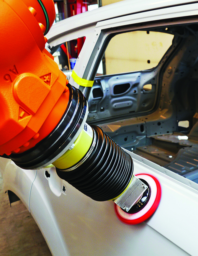

Here, a sensor-feedback flange from KEBA Corp. (called the Active Contact Flange) helps a robot arm buff an auto body with enough precision to ready the surface for a smooth coat of paint. Such end-effector fixtures are increasingly common on six-axis robot arms.

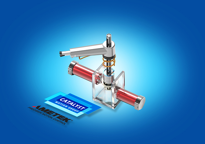

This Z-theta system is from Haydon Kerk motion system integrator Catalyst Motion Group. Z-theta systems offer a compact and effective package for a rotary axis and a linear axis in a single unit that work concurrently to output a helical motion path. Z-theta systems can also move to defined linear positions, then perform independent rotary moves. Loads of up to 100 lb and speeds in excess of 10 in./sec are possible.

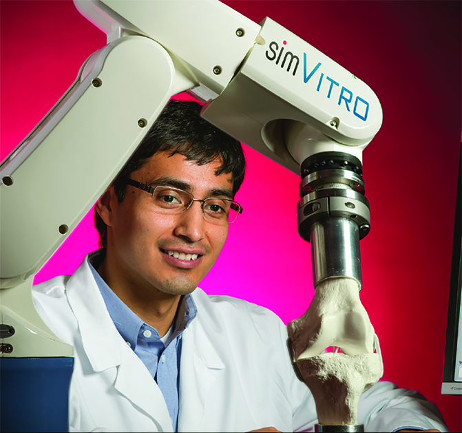

ATI Industrial Automation’s Force/Torque Sensors provide real time force feedback for a cutting-edge orthopedic simulator. The BioRobotics Laboratory at the Cleveland Clinic has created and launched a new robotics testing technology for orthopedic biomechanics research that integrates with ATI Multi-Axis Force/Torque Sensor systems. Real time force feedback control is at the core of this system’s control technologies. The sensor system measures all six components of force and torque and provides a common solution for force and torque control whether it is the lower loads required to articulate the smaller joints in the hand or higher loads required for knee or foot testing.

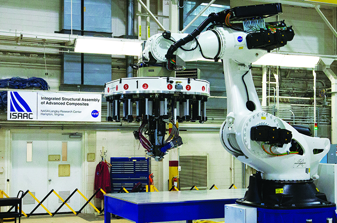

NASA's Langley Research Center is in the process of setting up this advanced composite research capability that engineers are calling ISAAC for Integrated Structural Assembly of Advanced Composites. The goal of the ACP is to reduce the time for development, verification, and regulatory acceptance of new composite materials and design methods. NASA will meet this objective through the development and use of high fidelity and rigorous computational methods, new test protocols, and new inspection techniques.
NASA’s Langley Research Center is in the process of setting up this advanced composite research capability that engineers are calling ISAAC for Integrated Structural Assembly of Advanced Composites. The goal of the ACP is to reduce the time for development, verification, and regulatory acceptance of new composite materials and design methods. NASA will meet this objective through the development and use of high fidelity and rigorous computational methods, new test protocols, and new inspection techniques.

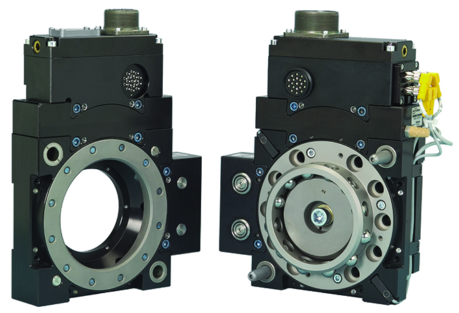

06-INSET-ATI-Tool-Changer-Robotic-Carbon-Fiber-System
