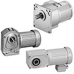

Another way to classify gearmotors is by the physical arrangement of the final complete unit. For instance, there are so-called inline gearmotors where the gear shaft is parallel with the motor shaft, also called a parallel shaft. These can either be offset from the output shaft or completely in line with it. Another configuration is the right-angle gearmotor, where the output shaft is at a 90-degree angle to the motor shaft. Some also refer to a planetary configuration, which describes the configuration of the gears inside the gearmotor. Because of the arrangement of the gears inside the motor in a planetary fashion, these types of gearmotors tend to be more compact in size and also offer high torque density. Shaft arrangement is generally inline, which eliminates any issues with shaft offset.

This photo of gearmotors from Oriental Motor shows some of the most common gearmotor configurations; an inline model (or parallel shaft), right angle with shaft, and right angle with hollow shaft.
