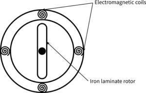

Dyson-vacuum-uses-switched-reluctance-motorSwitched-reluctance motors are stepmotors that accept power to their stators (instead of their rotors) to use output mechanical force through the use of reluctance. This is magnetomotive force to magnetic flux.
Switched-reluctance motors use drives that differ from those that pair with other stepper motors. That’s because switched-reluctance motors have nonlinear magnetic behavior … but output high speeds and reliable operation when driven correctly.
stepper-drives-FAQ-11-motor-reluctance-1-1One difference is that drives for switched-reluctance motors must compensate for torque ripple. Traditional setups also need position feedback and sensors. Here, sensors ultimately make the whole design more costly … so some newer controls run algorithms for driving switched-reluctance motors without sensors.
