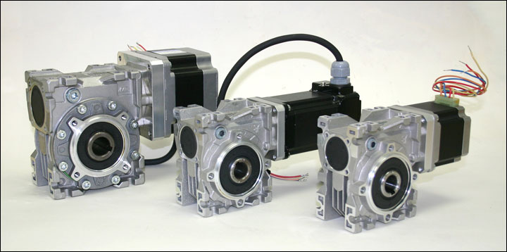

Shown here are servo and stepper motors from Diequa Corp. with worm gearsets. Gearing is helpful in reducing the inertia mismatch to suitable ratios. Note that traditional worm sets only connect to standard ac motors through quill adapters … but the Diequa sets here use backlash-free elastomer jaw couplings and locking devices to connect to the motor output shaft.

There are a few ways to handle inertia mismatch. One is simply to size and match motor and load and ensure that the load-to-rotor inertia ratio falls between 1:1 and 10:1 or close to it … with 3:1 being suitable for high-performance systems.
If for whatever reason this is not feasible, some techniques exist for handling excessive inertia mismatch. One approach is to drive the motor through long acceleration and deceleration periods so the motor doesn’t miss steps and nothing falls out of sync. One caveat: this degrades efficiency and throughput, because there’s more of a wait for getting to full speed and for coming to a complete shutdown. One fix is to use a properly designed gearhead on the motor. This can address inertia mismatches, though this introduces more design considerations and complexity.
