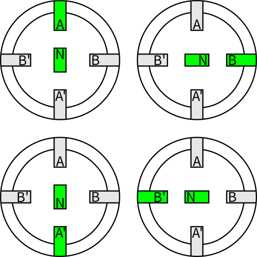

A stepper drive is the driver circuit that controls how the stepper motor operates. Stepper drives work by sending current through various phases in pulses to the stepper motor. There are four types: wave drives (also called one-phase-on drives), two-phase on, one-two phase-on drives and microstepping drives.
Wave or one-phase-on drives work with only one phase turned on at a time. Consider the illustration below. When the drive energizes pole A (a south pole) shown in green, it attracts the north pole of the rotor. Then when the drive energizes B and switches A off, the rotor rotates 90° and this continues as the drive energizes each pole one at a time.
Stepper Drive One Phase On
Engineers rarely use wave driving: it is inefficient and provides little torque, because only one phase of the motor engages at a time.
