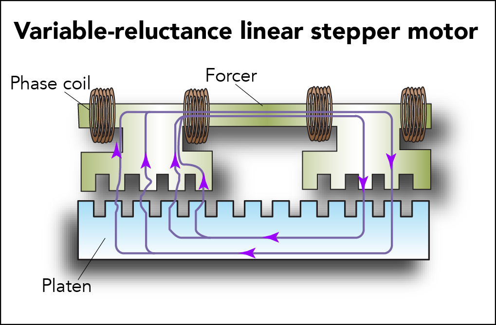

Variable-reluctance linear stepper motors
Variable-Reluctance Linear Stepper Motor
A variable-reluctance linear stepper motor resembles a hybrid linear stepper motor, but without permanent magnets. Current into the coils switches on and off to the motor phases, which in turn generates electromagnetic reluctance … and linear force with it.
Variable-reluctance linear steppers usually run under three-phase closed-loop control. In short, a forcer with laminated magnetic steel stacks and coils engages a platen when a drive energizes the coils with pulse trains. Each branch (or phase) has one or more teeth; coils wind between the teeth. With no permanent magnets in the setup, the sole input is current.
Variable-reluctance linear stepper motors are an older technology than hybrid motors. Like rotary variable-reluctance stepper motors, variable-reluctance linear steppers can be noisy and are usually only run in full-step mode. But the motors have their own benefits:
  • Their platen-forcer electromagnetic coupling minimizes core losses.
  • They exhibit less torque drop at higher speeds.
  • They are less costly than hybrid linear steppers.
