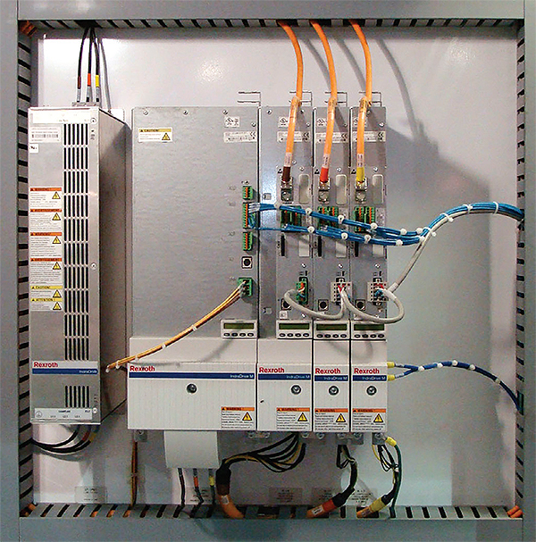

Some of today’s most cutting edge systems, such as the Rexroth IndraDrive Mi integrated drive/motor systems, include a highly energy-efficient feature: bus sharing. Multiple drives are daisy-chained together and share power from the same bus; in many multi-axis machines, as some motors are accelerating up to speed (drawing power), others are decelerating (regenerating power). With bus sharing, rather than having to deliver maximum power to the accelerating motors and bleed off the decelerating motors into heat across a bleeder resistor, power is shared, so the machine’s power consumption is significantly reduced.
regenerative-power-supplies
Regenerative power supplies feed power back through a shared bus to re-use on the machine rather than dissipating excess power as heat.
A further energy-efficient technology is called regenerative power supplies. In many machines, multiple servomotors will decelerate at the same time, boosting the voltage to excess levels on the power bus. Older generation electrical drives would bleed that excess electrical energy as heat—wasting the power and adding to the factory floor’s heat production, requiring additional cabinet cooling. With regenerative power supplies coupled to a shared bus system, what was once wasted power can now be fed back through the shared bus and sold back to the electric company.
