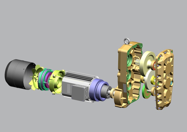

A 3D CAD model of a gearmotor for extreme environments from ABM Drives.
Gearmotors and high temperatures
What happens to the gearmotor when the temperature drops to -40 C?  From -40˚ C (-40˚ F) to +60˚ C (+140˚ F) a meter of ductile iron expands 0.123 mm. That’s the temperature range we’ll be covering here. Altitude is the other extreme we’ll be covering. For an internal combustion engine, the general rule of thumb is a 3 to 4% power loss for each 1,000 feet above sea level. So a 300 hp car at 10,000 feet loses 30 to 40 hp. Less density means less compression. Less actual matter in the atmosphere (oxygen, nitrogen, and argon mostly) is being drawn into the cylinders, and therefore compression is less. For a gearmotor, that means less atmospheric matter to dissipate heat.
So, how to compensate for temperature extremes? (A standard temperature range is -20 to +40° C.)  A common extreme temperature swing is when a forklift moves from a -30˚ C freezer to a +40° C dock door. For both extremely cold (-40˚ C) to very hot conditions (+60˚ C) you’ll need to address the following.
Gearbox oil: Synthetic lubricants are used when mineral oils have reached their performance limit for frequent starts and stops, high loads, system shocks, low or high-temperature service, extended oil service interval requirements and reduced internal friction besides reduced operating temperatures. They also operate at higher temperatures without losing viscosity, forming residues and offering resistance to foaming. Petroleum products begin to degrade at or below +100°C, whereas synthetic hydrocarbon lubricants function well to +125°C. Synthetics offer extreme low-temperature advantages as well. They also have lower vapor pressures than petroleum products, an important factor in ensuring that the lubricant doesn’t break down. The chemical homogeneity of synthetic lubricants results in greater load carrying capacity, higher viscosity indexes, better lubricity, greater efficiency and extended serviceability than their petroleum-based counterparts.
Shaft seals: If the gearmotor remains at low temperatures for extended periods of time, upgrade motor shaft seals to NBR (elastomeric) material or use high-grade grease for shaft seal lubrication. Elastomeric materials are composed of a polymer, filler, processing aid, protectants, and curing agents. Many times standard oil seals are made of Nitrile or rubber and are rated for temperatures up to +125˚ C. If ambient or oil temperatures rise above this level, you will have to use higher performance materials.
Motor cooling fan: These should be made of aluminum, GGG (nodular iron) or special plastic material.

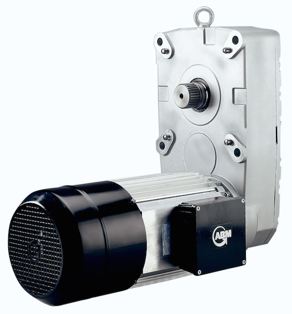

Gearmotor systems for demanding applications, such as dockside crane hoists, trolley and bridge drives, need to be engineered for many years of severe duty cycles that demand minimum maintenance.

For proper function and use in temperatures from -20° to -40°C …
Housings: Switch end shield material from GG (grey cast iron) to GGG (nodular iron). Nodular ductile iron possesses high strength, ductility and resistance to shock. Annealed nodular ductile iron can be bent, twisted or deformed without fracturing. Its strength, toughness and ductility duplicate many grades of steel but have low-cost casting procedures similar to gray cast iron. Ordinary gray cast iron has a random flake graphite pattern. Nodular ductile iron has a few hundredths of a percent of magnesium or cerium in its formula causing the graphite to form in small spheroid “nodules” rather than flakes. They cause fewer discontinuities in the structure of the metal for a stronger, more “ductile” iron. You can also use aluminum if allowable stress is not exceeded.
Rotor shaft: Switch material from 1045 steel to alloy steel, e.g., 42CrMo4 or similar. 1045 is a low hardenability carbon steel with a typical medium tensile strength range of 570 to 700 Mpa or Brinell hardness range of 170 to 210. It’s characterized by fairly good strength and impact properties. 42CrMo4 Alloy Steel is chromium-molybdenum steel with high strength and hardenability. It has high fatigue strength and good low-temperature impact toughness.
Motor heating: This could be a heater jacket, motor heating bands or the winding could be powered to maintain a certain temperature (this is also used to prevent moisture build-up in high humidity environments). External heating jackets, covers or housings are often installed by crane builders because they also need to protect the gearbox and other components.
Junction boxes: Switch from plastic to aluminum.
Fan shroud: Switch from plastic to a sheet-metal version.
Brake design: Choose a completely enclosed instead of an open design.
Derating torque: It might even be necessary to de-rate the maximum acceptable gearbox torque or use a larger gearbox.

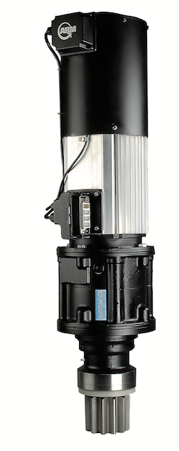

Wind turbine pitch drives are engineered for decades of continuous duty cycle that demand minimum maintenance and must satisfy the toughest requirements for reliability and durability.
