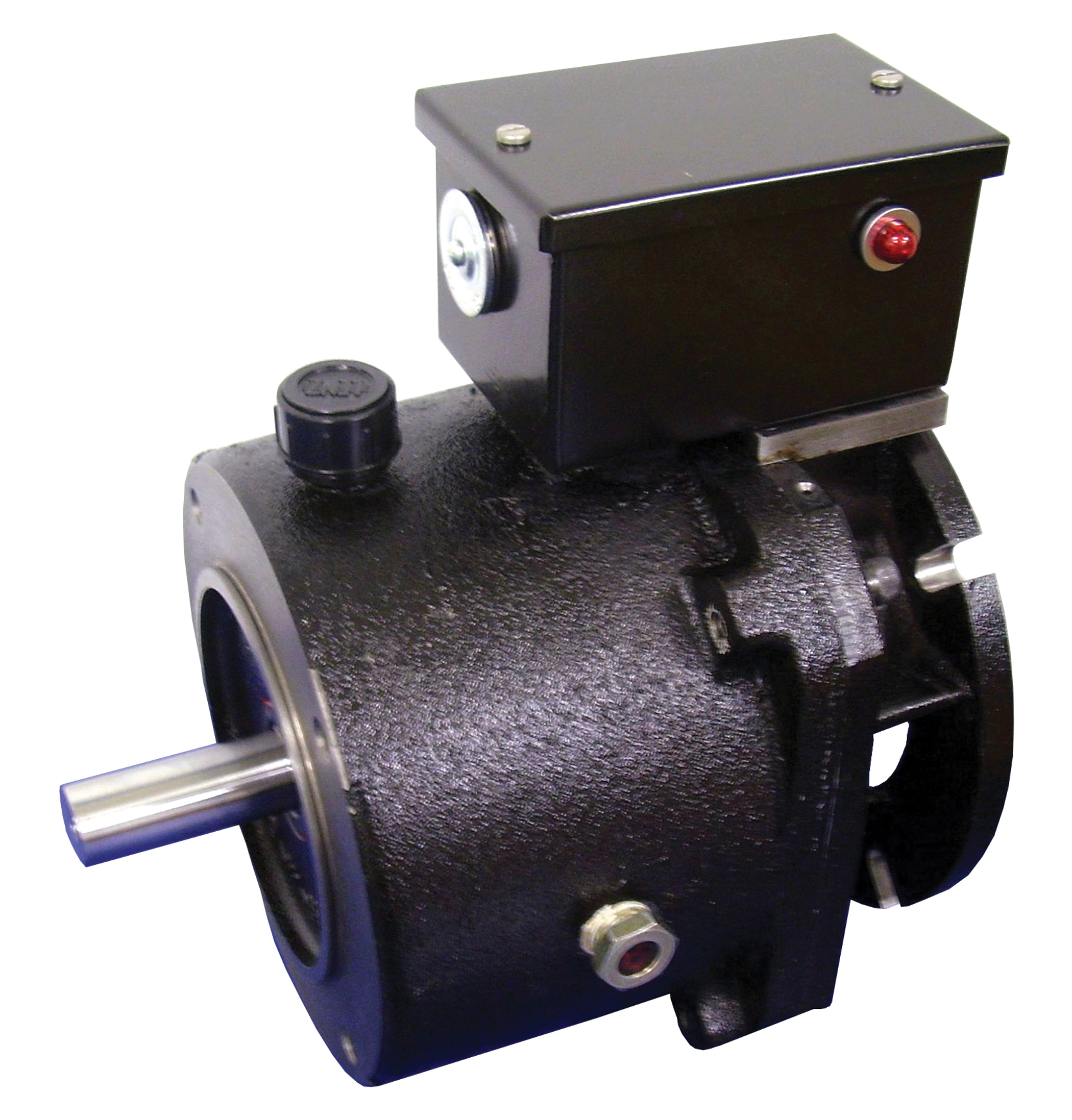

This is a Force Control Industries coupler brake. In fact, the company’s Posistop and MagnaShear coupler brakes mount between motors and reducers, so engineers can eliminate separate brake motors.

Clutch and brake combinations go where load is started and stopped while the motor continues to rotate. Both clutches and clutch brakes can mount to a motor shaft or be base-mounted and have input through a belt drive, chain drive or coupling.
