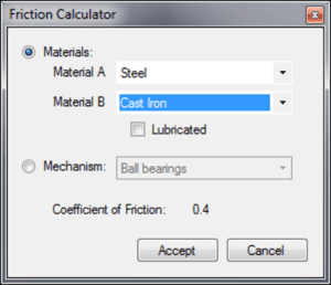

Chain-and-sprocket design friction calculation: For the friction number, because cast iron is the most common and economical material for sprockets and chains are generally made from carbon or alloy steel, the Materials A and B can be selected as such:

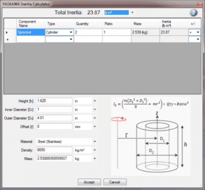

  2. Power-transmission sprocket inertia: This is the inertia of the mechanism that will move the load mass. Again, sizing software will assist in finding this number … and the engineer need only enter a few sprocket details.

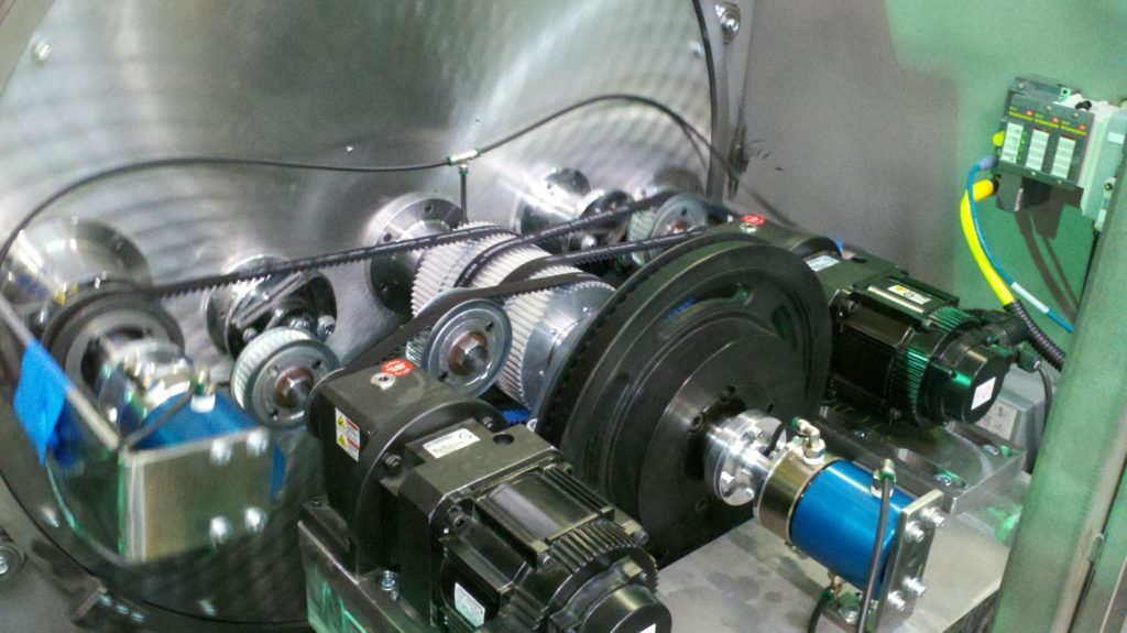

Now consider the power-transmission assembly as a whole. The transmission of a motion system represents everything between the electric motor’s output shaft and the mechanism it’s driving. This power-transmission driveline can be as simple as a gearbox or as complex as a serpentine-belt pulley system running over multiple idlers and driven axes. For these applications as well as our example chain-and-sprocket setup, Yaskawa’s gearmotors offer an easy integration solution.

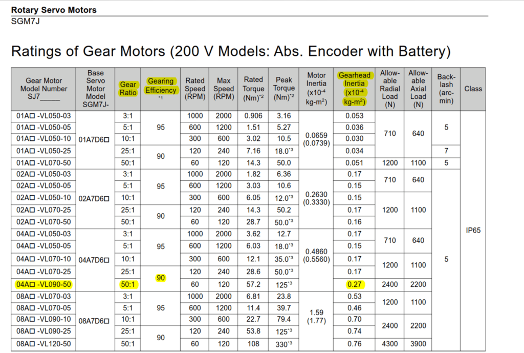

The Sigma-7 Technical Supplement can be downloaded via this yaskawa.com deep link. The transmission can be entered as such with the specification sheet for the particular model of gearbox:

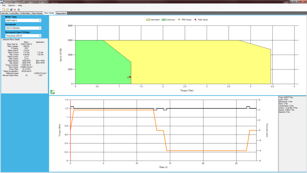

The next step is to account for the axis’ required move profile. As with all move profiles, it’s important to account for a forward (up) move and a reverse (down) move. Moving the axis in the upward direction requires the use (in design calculations) of the mass load to determine the speed and torque required. Of course, when the axis moves its load downward, the mass payload and gravity are the determining values. Any axis involving a vertical drop will likely incorporate regenerative energy in the motion system … and the servo amplifier (in our example case, a Yaskawa SERVOPACK) must accommodate this energy. Otherwise, an external regenerative resistor will be required.
Assume our move profile involves a 4 in. per second velocity over a 50-in. stroke to give:

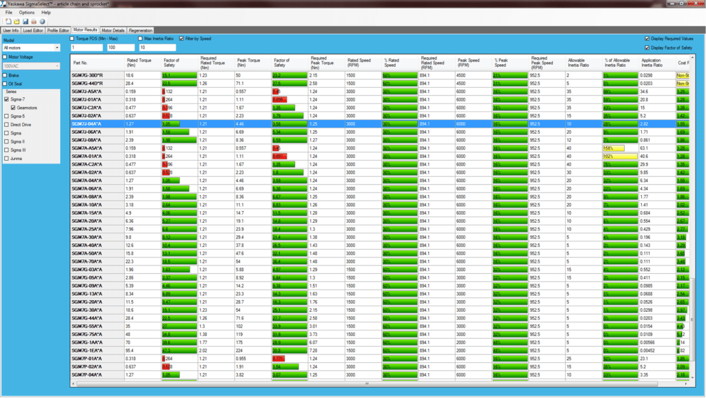

After accounting for the design’s move profile, the next step is to select a servomotor. This servomotor should be capable of handling the system’s speed, torque, and inertia. For our example case, Yaskawa’s Sigma-7 SGM7J Series at 400 W can handle the load and move profile.
