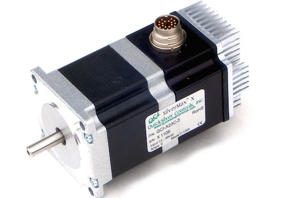

The SilverMax X-Series from QuickSilver is a fully integrated hybrid servomotor with feedback, a controller/indexer, and a digital driver all in one.

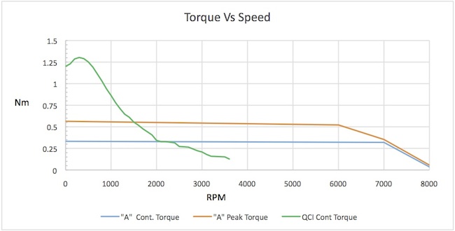

Looking at the torque curves for the two motor types indicates a number of things. The curves show that the hybrid servo has more continuous torque up to approximately 2,000 RPM, and more continuous torque than the “A” motor has peak torque up until approximately 1,500 RPM. These are important speeds for direct- drive applications; that is, with the motor directly driving the load without a gearhead. A typical lead screw (¼ in., 24 in. long, both ends secured with a single bearing) has a critical speed approximately 1,600 RPM, while extending the leadscrew to 36 in. drops the critical speed to just over 700 RPM. A typical direct drive belt drive (1-in. diameter pulley = 3.14 in./rev) moves at 52 in./sec while rotating at 1,000 RPM.
servo
The torque-speed curve compares torque for the hybrid servomotor and a conventional servomotor, showing that the hybrid motor has more continuous torque at lower speeds.

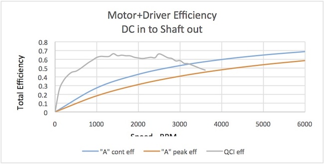

The motor efficiency for the QuickSilver Hybrid servo was directly measured, while the efficiency for the traditional servo was approximated based on the torque and the I2R losses and estimated speed related losses, as well as the input current of 6.6 A at 48 V producing 0.33 Nm at 6, 500 RPM (226 W out, 318 W in, some 92 W dissipated as heat). With the continuous torque curve stated as based on an 85 ˚C case temperature, the power being dissipated by the motor has been taken as approximately continuous across the speed range for these calculations. What is readily apparent is that the hybrid servo motor and controller are significantly more efficient than the conventional servo motor up to about 3,200 RPM. At 1,000 RPM, mid-range for many direct-drive applications, the hybrid servo is some 225 % as efficient than the continuous operation of the conventional servo motor, and some 300 % as efficient when compared to the peak torque curve of the conventional low pole count motor (which is still only producing about 64 % of the hybrid servo torque). Again, there is a wide speed range of high efficiency operation for the hybrid servo motor.
servo
A graph of efficiency versus speed reveals that the hybrid servomotor and controller are significantly more efficient than the conventional servomotor up to about 3,200 RPM.
Here, the curve has been somewhat truncated to show the direct drive range of speeds; the “A” system eventually reaches an efficiency of 71 % at the Nominal Continuous power point of 6,500 RPM. While this may be useful for applications that actually need this speed, it is not accessible for most direct-drive applications.
