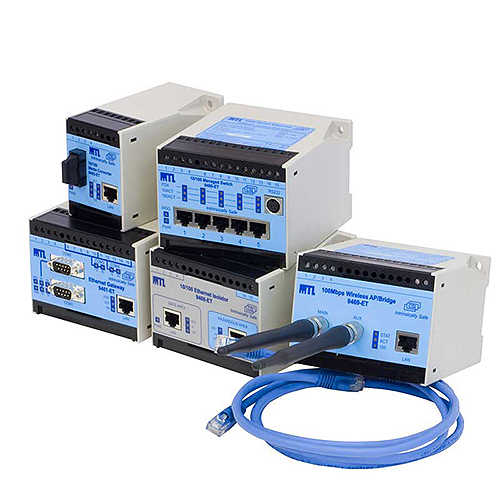

MTL Instruments (www.mtl-inst.com) has unveiled a cost-effective Intrinsically Safe (IS) Ethernet device that can be easily installed and maintained in hazardous environments. IS Ethernet equipment’s 9460-ET Series is comprised of IECEx certified components that includes IS Ethernet Switch, IS Copper to Fiber Converter, IS Serial – Ethernet Gateway, IS Ethernet Isolator and IS Wireless AP/Bridge.

Its intrinsically safe hazardous area certification allows the components to be positioned in a Division 1, or Zone 1 hazardous area. Offering connectivity to Zone 0, the associated apparatus certification of the 9491-PS IS power supply and the 9468-ET IS Ethernet isolator enable the equipment to be positioned in a Zone 2 hazardous environment, while connecting to intrinsically safe equipment in a Division 1      , or Zone 1 or 0 hazardous area.
