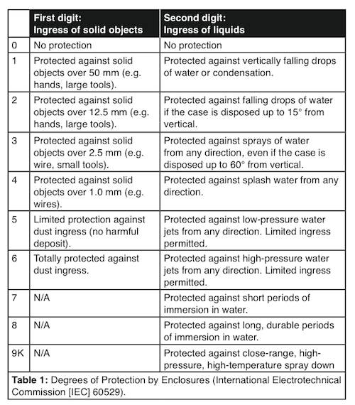

One of the best indicators of a system’s sealing effectiveness is the International Protection Marking, or IP Code. Its ingress protection (IP) rating is the global standard for measuring protection from the ingress of solid objects and liquids. The IP rating specifies the degree of environmental protection an enclosure provides against foreign materials that could impact operation.
The IP rating is composed of two numbers (see Table 1). The first number represents resistance to solids and the second to liquids. An IP rating of 00, for example, means there is no protection from solids or liquids. An IP rating of 11 means protection from ingress by objects larger than 50 mm and from rain or condensation. An IP rating of 66 means protection from penetration by particulates the size of dust and from high-pressure water jets from any direction. This rating is also considered the minimum for use in harsh environments today.

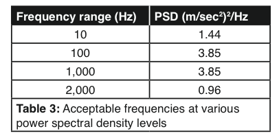

To ensure that common vibration profiles can be completed without damage to the product, test protocols, usually OEM specific, are run on multiple components and planes, including protocols for testing housings, structural bolts and any included printed circuit assemblies or sensors. Testing is conducted with the unit not powered or operating and mounted on a vibration machine guided by the power spectral density (PSD) levels shown in Table 3. The device being tested should extend half of design maximum and be tested in three orthogonal axes for 24 hours each.
