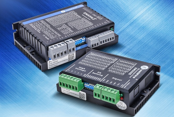

Leadshine 2-phase digital micro-stepping drives with micro-stepping motor movement and anti-resonance for optimal torque, provide extra smooth motion, low motor heating and noise. These drives accept a wide range of input voltages (12 to 110 Vdc, 18 to 80 Vac) and provide over-voltage and overcurrent protection, motor auto-configuration on power up and Soft-start at power on. Motor output current ranges from 0.3 to 7.2 A.
stepper drives
Leadshine drives support NEMA 11, 14, 17, 23, 24, 34 and 42 frame size step motors with pulse input frequency up to 200 kHz. All drives support step and direction control, with some models supporting CW/CCW as well. DIP switches are used for built-in self-test, microstep resolution selection, current level selection, and optional idle current reduction.
Leadshine stepper drives offered by AutomationDirect are priced from $25.50 and have a 1-year warranty.
