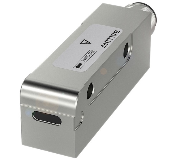

Balluff’s BML absolute magnetic encoder in the SGA series stands out in any application where high absolute accuracy of position and end-of-travel is required. Comprehensive diagnostics functions ensure reliable operation and more efficient maintenance. With its Drive-Cliq interface the Balluff measuring system can also be easily integrated into Siemens controller environments, with Siemens having certified the system accordingly.
Plug-and-play installation makes incorporating the BML into the drive system easy. The controller automatically detects the sensor and its basic settings. The sensor also offers great flexibility, since leaving and reengaging with the tape is permissible. This opens up simple and economical solutions for demanding applications in automation as well as machine tool building, including specialty machines.
encoder
Because the system works magnetically, it’s also extremely insensitive to temperature change, dirt (such as from dust and oil), or wear. Thanks to its compact form factor the measuring system is also easy to integrate into existing applications, even in tight mounting conditions. The generous read distance of 1.3 mm makes installation easier.
In practical operation continuous plausibility checking ensures high reliability, as the system consistently checks the measurement quality. Automatic condition monitoring checks the signal quality and, using the controller, is a convenient way to evaluate the function reserve. Status LEDs and diagnostic functions ensure reliable operation and more efficient maintenance.
The linear measuring system is suitable for both long measuring lengths up to 48 m as well as for applications which require high precision. With an accuracy of up to ± 12 μm and a resolution of 1 μm the measuring system meets these requirements.
