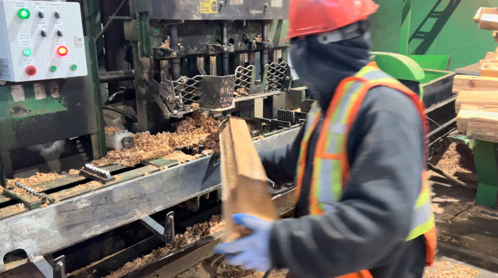

On the manufacturing floor of British Columbia-based BKB Cedar Manufacturing, the whine of the drill motor and churning of its bit into tough cedar posts made a reassuringly steady cadence — until, too often, it didn’t.
Workers would manually position posts by moving a heavy carriage back and forth between drilling operations. They would then manually drill into the posts, expecting a smooth down-and-up motion, only to hit a knot that snared the bit and halted production. This labor-intensive process was already slower and more physically straining on operators than BKB Cedar wanted, but jams, dull bits, and other unexpected snags only made it worse. The company struggled to meet production deadlines — often adding a second operator to the drill station just to keep pace. But even with two people, production peaked at 600 posts per eight-hour shift.

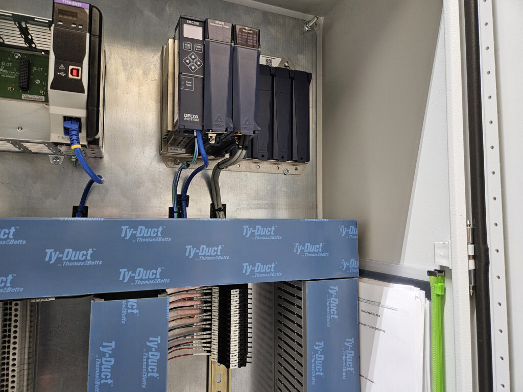

Newfound reliability with Delta’s precision motion-control transformed what was once a manufacturing bottleneck into a competitive advantage, proving that sometimes the smartest investment is to upgrade system controls rather than replacing machines outright. Shown here is the Delta Motion controller in a cabinet with other machine electronics.
This involved careful assessment and multiple iterations. PQ Systems went back and forth a lot with the client to understand the motion, weights, and forces in play. Overhauling the system included sizing a new cylinder, selecting a correctly sized Moog D634 servo proportional valve, and integrating Temposonics position feedback. Through this detailed hydraulic and mechanical refinement, MicroWest and PQ Systems laid the foundation for advanced motion control. As de Rot put it, after the extensive work on the hydraulics, “the magic of the RMC took over from there.”

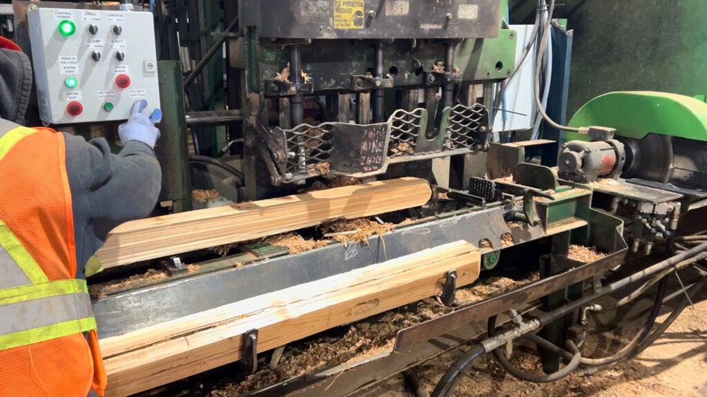

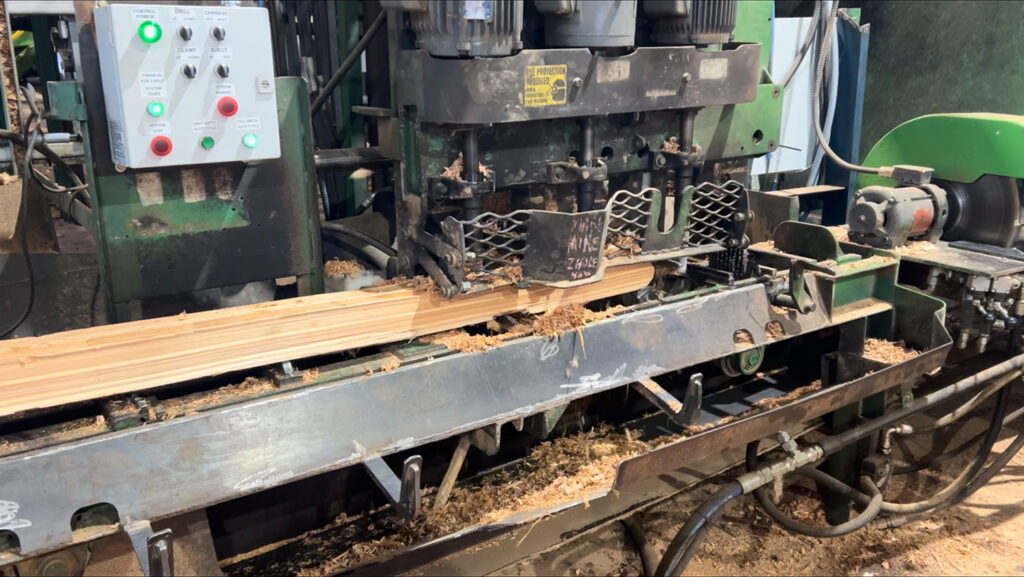

For BKB Cedar, Zuhlke, with guidance from PQ Systems on the motion controller selection, opted for Delta Motion’s RMC200. The controller provided three critical functions for the fence drill retrofit: vertical drill positioning, horizontal carriage movement, and pressure monitoring to prevent jams. The choice of the RMC200, specifically a seven-slot version, also provided BKB Cedar with room for future expansion.
“The solution uses the vertical position as well as the pressure to control the up-down movement of the drill,” explains Zuhlke. “The Delta controller subtracts the pressure readings from either side of the cylinder and converts that to force. If it’s going down too fast and there’s too much force, the controller sees that pressure feedback and slows the speed, so it doesn’t jam the drills.”
Before automation, BKB’s drill operators drove bits to mechanical stops, wasting motion and time. The Delta-powered system uses lasers to measure post thickness, enabling an exact 1.5-inch drilling depth regardless of post variations. This precision enables smarter drilling profiles.
For BKB Cedar, productivity gains and operational reliability creates compelling value. “The operators say the system just runs without a hitch, and that impresses them,” said Zuhlke. “Every day, it starts up and runs the way it should.”
“With Delta’s motion control,” said Zuhlke, “we go full speed down until we get to the wood, then we slow the drilling speed. And when it comes out of the hole, we go full speed, as well. We promised the client fifteen-second cycle times. They’re averaging ten now.”

Results were dramatic. The revamped drill system shattered BKB’s production records while dramatically reducing physical strain on operators. “Their previous record was between five and six hundred posts [per shift] with two people,” Zuhlke noted. “Now they’ve topped over eight hundred with one operator. They’ve almost doubled their previous rate.”
Beyond throughput, the system eliminated the frustrating downtime caused by jammed drills and the safety hazards of manual jam removal.
Previously, operators would encounter knots at typical rotation speeds, and the bit would jam before the operator could detect a problem. Once a bit jammed, getting it out was difficult.
“Whenever something happens out of the norm, that’s when there’s a possibility of injury,” added Zuhlke. When you need to unstick or fix something, what’s your first instinct? Reach in, right? You shouldn’t get your hands in there, but the temptation is always to try and get production running again.”
Fortunately, the Delta-based solution monitors both pressure and motor current. The system automatically recognizes changes at the microsecond scale and slows the bit accordingly to eliminate jams and their resulting downtime, improving both throughput and safety. The automated system also eliminated the need for operators to lean in close to manually align posts, replacing human positioning with laser guidance that keeps workers at a safe distance from the drilling operation.
This vigilance also improves quality. “Now we’re drilling a one-and-a-half-inch hole,” said Zuhlke. “We’re not just ramming the drill down to a stop that’s strangely high off the work surface. The system actually sees the top of the post and knows precisely how far down we need to go. So, the output is exactly to spec, and customers are happier with the quality.”
