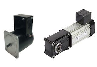

Bison Gear and Engineering has rolled out a new line of brushless DC (BLDC) gearmotors and motor only products. The new BLDC product line offers improved speed control, sophisticated programmability, less wear and noticeably quieter operation when compared to PMDC motors. BisonGear BLDC Gearmotors
The new BLDC line combines the design advantages from Bison’s most popular products with an efficient BLDC motor that provides improved power density and long-lasting reliability. The BLDC line comes in 12V and 24V versions and features these products:
  • 100 Series Parallel Shaft Gearmotor
–          1.8 – 500 rpm
–          1/20 – 1/10 hp
–          12 – 160 in-lbs
  • 200 Series Parallel Shaft Gearmotor
–          12 – 500 rpm
–          1/10 – 1/6 hp
–          25 – 275 in-lbs
  • 750 Series Right-angle Gearmotor
–          42 – 481 rpm
–          1/10 – 1/6 hp
–          6 – 60 in-lbs
  • 720 Series PowerSTAR Right-angle Hypoid Gearmotor
–          21 – 250 rpm
–          1/10 hp
–          19 – 231 in-lbs
  • 725 Series PowerSTAR Right-angle Hypoid Gearmotor
–          10 – 250 rpm
–          1/10 – 1/6 hp
–          20 – 482 in-lbs
  • BLDC NEMA 34 Motor Only
–          2,500 rpm
–          Universal NEMA 34 Interface
The new gearmotor line is ideal for single-direction or reversible conveyor system equipment, peristaltic pumps and any application requiring precise speed control and positioning.
