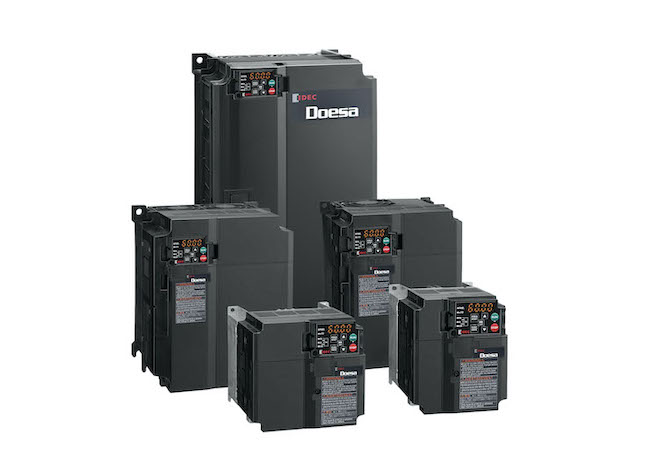

IDEC Corporation now offers a new line of VF1A Doesa variable frequency drives (VFDs), providing versatile control and efficient operation of electrical motors for a wide range of applications. IDEC VF1A Doesa VFDs are suitable for speed control of variable and constant torque applications ranging from fans and pumps to specialized equipment. The VFD is capable of driving an induction motor (IM) or a permanent magnet synchronous motor (PMSM). IMs can be driven in open loop or closed loop, while PMSMs can be driven in open loop only.
The product family features a compact form factor in a UL open-type construction, with nickel- and tin-plated bus bars and conformal coatings for corrosion protection. The VFD is designed for a long operating life, and provides a maintenance alarm signal.
drives
Electrical input is nominally rated as three-phase low voltage 400V ac (with an allowable input voltage range of 380 to 480 Vac), and the VFDs come in 14 models with a capacity range of up to 139 A. Each VFD is quadruple rated for varying duties—normal or heavy overload, and mild 40 °C or high 50 °C temperatures—so users can minimize the number of models needed to handle a wide range of applications.
Other advanced functionality includes control of mechanical brakes, a built-in braking transistor, regeneration avoidance, and low-voltage ride through. Safe torque off (STO) capability ensures the VFD fulfills functional safety standard requirements while eliminating the need for external circuit breakers required by conventional VFDs.
Logic programming with 55 functions, different calculations and sequences, and fast processing intervals lets designers eliminate other small controllers, and adapt the VFD to meet special requirements. The logic is configured via easy-to-use graphical software, letting users create customized automation applications of up to 200 steps, including PID control. Online logic, value, and trace monitoring helps users optimize and diagnose applications. Password protection is included.
The VFD also includes seven digital inputs, two analog inputs, three digital outputs, and two analog outputs for added control functionality. A standard option port and RS-485 terminals are included, and the VFD accepts removable terminal cards for standard, 5-V, and 12-V/15-V operation. Optional communication cards are available for easy integration of the VFD with PLCs and other intelligent devices.
An on-board keypad provides convenient status and diagnostic monitoring, along with local configuration and control capability. An optional external keypad makes it easy to set and save parameters in a convenient location—using a PC and software if desired—and then later connect this keypad locally at the VFD for downloading the configuration.
