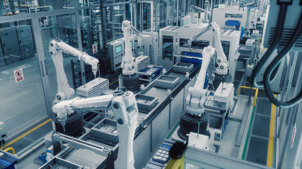

There are various complexity levels with these peripheral motion systems. The act of machine tending is simpler than assembly … and most assembly tasks are in turn simpler than operations involving conveyance. The latter represents material handling in the form of pick-and-place functions (like what we’re seeing below) needing the coordination of all the robot axes and end effector with the conveyor. For such setups, the location of the robot relative to the conveyor (along with a whole host of other parameters) can be optimized in simulation software for minimized arm travel.

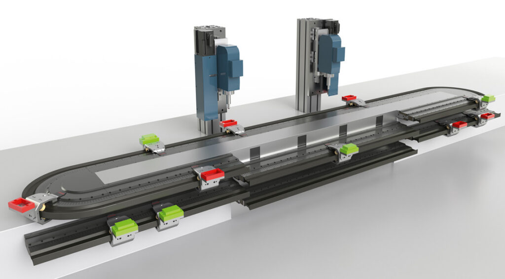

Robotic applications run with simpler controls blindly move to workpieces, so need those workpieces to be in an exact location on the conveyor. But something needs to impart precision to the operation. In many such cases, this comes from a servodriven conveyor. Industry-typical repeatability for servodriven belt conveyors is to ±0.75 mm at 100 indexes per minute. Linear-transfer systems based on direct-drive tracks (akin to linear motors stretched into a racetrack conveyance loop) can be ten times more precise with ±0.075 mm repeatability. But with conveyance this precise, articulated robotic arms aren’t the common pairing. Instead, stationary assembly machinery is more typical (as illustrated by this Beckhoff example):
