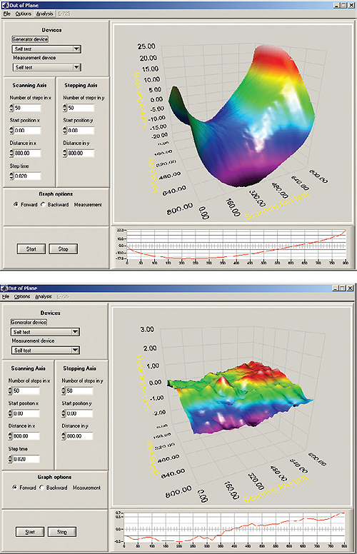

The same approach yields superior surface metrology results in atomic force microscopes (AFM). Progress in semiconductor development relies heavily on materials testing, and an AFM’s output data is only as good as the out-of-plane motion (OOPM) of the XY scanning stage it employs. Here, traditional bearings are totally out of the question and the requirements have been pushing the mechanical limitations of the best flexure designs. Active trajectory control approaches (compensating minute off-axis errors with integrated piezo transducers) now provide OOPM in the sub-nanometer realm, over large scanning areas to hundreds of microns, Figure 2.
out-of-plane-motion-scan
Figure 2. Improved out-of-plane motion of AFM scanner with active trajectory control.
