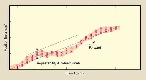

repeatability graph
The graph of position error over travel range defines unidirectional repeatability.
Repeatability, the most fundamental standard of system performance, defines the variation in results for a series of moves or, more analytically, the width of the dispersion about the mean for a significant number of positioning trials. Repeatability, a statistical quality, is commonly defined for a normal distribution by the dispersion width corresponding to a number of standard deviations.
Usually, three-standard deviation repeatability (3 Sigma) is specified. Consider, for example, a positioning system with a repeatability specification of 0.0001 in. For 3 Sigma specification, any series of identical movements will fall within a dispersion width of 0.0001 in. with 99.74 confidence. By way of comparison, 2 Sigma equates to a 95.44 confidence, while 6 Sigma corresponds to a 99.9997 confidence interval. Frequently, motion systems are only required to demonstrate consistency or minimal variability to provide uniformity of the resulting product. In such cases, repeatability is the only attribute necessary to satisfy the precision requirement.
Unidirectional repeatability involves approaching the target position from only one side. It’s affected by non-constant static friction, termed stiction, and the degree of torsion stiffness in the drive train. Stiction gives rise to movement characterized by a breakaway jump as force is applied to initiate motion, while inadequate torsion stiffness causes windup, which is motion input without a corresponding output displacement.
