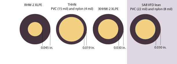

The solution here is to pick cables with PVC insulation that’s thicker than the listed National Electric Code (NEC) standards for THHN wire and even drive-manufacturer recommendations. Also note that per NEC Article 310.10, THHN PVC insulated cables should be used for dry and damp locations; for wet locations, designers should use cross-linked polyethylene (XLPE) XHHW or RHW-2, because heat generated by the creation of nitric acid forms a thermally isolating charred layer on the XLPE surface that can prevent further degradation.
For example, some Allen Bradley wire-selection flowcharts recommend that designers use PVC insulated cables with a minimum of 20-mil insulation for dry conditions and XLPE (XHHW-2) for wet conditions. The thicker insulation on cables reduces the harmful effects of reflective waves, as it increases the corona-inception voltage (CIV), the voltage level at which corona initiates.
For runs longer than 50 ft, PVC insulation should be a minimum of 20 mil—or use XLPE-insulated conductors.

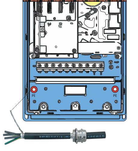

To prevent EMI in VFD systems, ABB recommends grounding the shield with 360° contact at the enclosure entrance and the motor, and to pigtail the shield to the PE terminal on the drive. Some cable manufacturers agree that this is the best solution … and offer a grounding connector with 360° contact for the entry of the cables to the enclosure.
Note that proper grounding of the enclosure and motor, followed by proper shielding of VFD cables, creates what is essentially a Faraday cage. A Faraday cage is an enclosure formed by conducting material. Such an enclosure blocks external static and non-static electric fields by channeling electricity through the enclosure to ground. This in turn makes for constant voltage on all sides of the enclosure. Because the difference in voltage is the measure of electrical potential, no current flows through the space.
To prevent electrical noise, always terminate shields at both ends—at the motor and the drive. The shield acts as a ground path for electrical noise and stray CMC, so proper termination is essential.

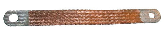

Due to the skin effect at high frequencies, don’t use a single terminated drain wire. It doesn’t provide adequate surface area to conduct the high frequency noise to ground. Rather, it’s best to tie the shield directly to the PE terminal at the drive. Because VFD signals have a very high frequency, they exhibit the skin effect on wires at those high frequencies.
As a review, the skin effect is a tendency for alternating current to flow mostly near the outer surface of an electrical conductor. The effect becomes more and more apparent as the frequency increases.
This is also why it’s best to use a ground strap instead of solid round wire for grounding.

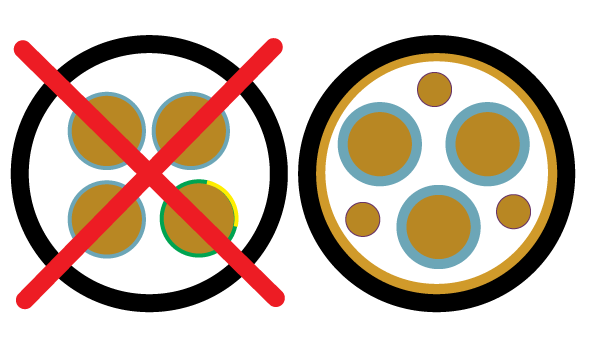

5. Never use unshielded cables in conduit or tray to prevent unintended paths to earth ground, creating ground loops. In addition, cables must have proper shielding and grounding where they connect to the drive enclosure and where they connect to the motor. For this, use EMC glands and shielded cables.
