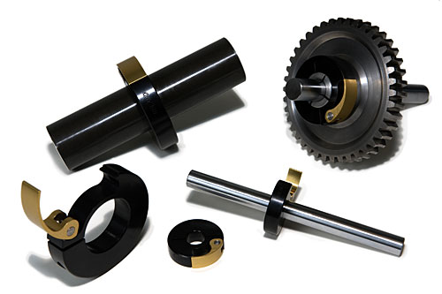

Marlborough, Massachusetts — Ruland Manufacturing Company introduces its new quick clamping shaft collars. The new collars do not mar the shaft, do not require tools and are designed for quick adjustments. They are ideal for light duty applications with frequent setup changes or adjustments or where the need for tools is not practical. The quick clamping collars are designed with a low profile clamping lever which makes them suitable for rotating and stationary applications. Industries such as printing and packaging, as well as others, can benefit from the use of quick clamping collars to retain frequently changed items, such as rolls of media, or for rapid and precise adjustments of guide rails or other setup fixturing.
The new quick clamping design shaft collars have advantages over their traditional one- or two piece clamp collars with screws and set-screw type collars: The quick clamping collars do not mar the shaft. They do not require tools to install or remove them, and are especially designed for quick adjustments. They also work well with light duty split hub components such as gears and sprockets and they can be machined to facilitate mounting of other components. The quick clamping collars are made from high quality aluminum with an anodized finish which has the advantage of being light-weight and having low inertia. The quick clamping shaft collars are available with bore sizes from 5/16″ to 1 1/2″ in the inch series and 8mm to 35mm in the metric series.
As all Ruland shaft collars, the new quick clamping design collars are single point faced to ensure perpendicularity and proper alignment. A precise shaft collar face to bore relationship ensures that components are both properly positioned and not tilted on the shaft. Collar face perpendicularity also ensures even pressure on interfaced components.
