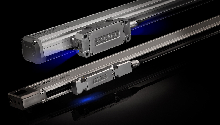

Also featured at Renishaw’s Automate 25 exhibit is the innovative FORTiS enclosed linear scale absolute encoder. Designed for use in harsh environments such as machine tools, a key feature of the FORTiS encoder enables significant reductions in purge air consumption.
FORTiS enclosed linear scale absolute encoders are designed for use in harsh environments such as machine tools.
The FORTiS encoder design is built on Renishaw’s industry-proven RESOLUTE encoder technology and provides high resistance to the ingress of liquids and solid debris contaminants. It features an extruded enclosure with longitudinally attached interlocking lip seals and sealed end caps. The readhead body is joined to a sealed optical unit by a blade, which travels through a pair of DuraSeal™ lip seals along the length of the encoder. Linear axis movement causes the readhead and optics to traverse the encoder’s absolute scale (which is fixed to the inside of the enclosure), without mechanical contact.
