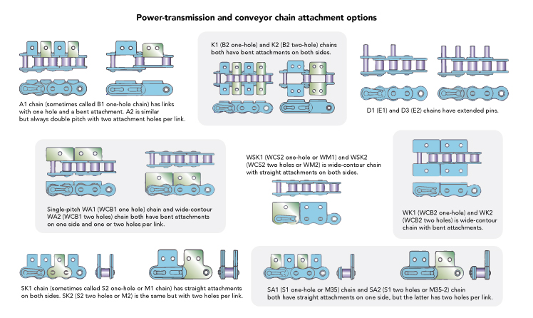

Conveyor chains come in myriad versions to move product horizontally, vertically or even around curved radii. The most common conveyor chains are ASME-style (ANSI-style) attachment chains. These chains include extended pins or plates with tabs onto which parts or product-holding shoes can bolt.

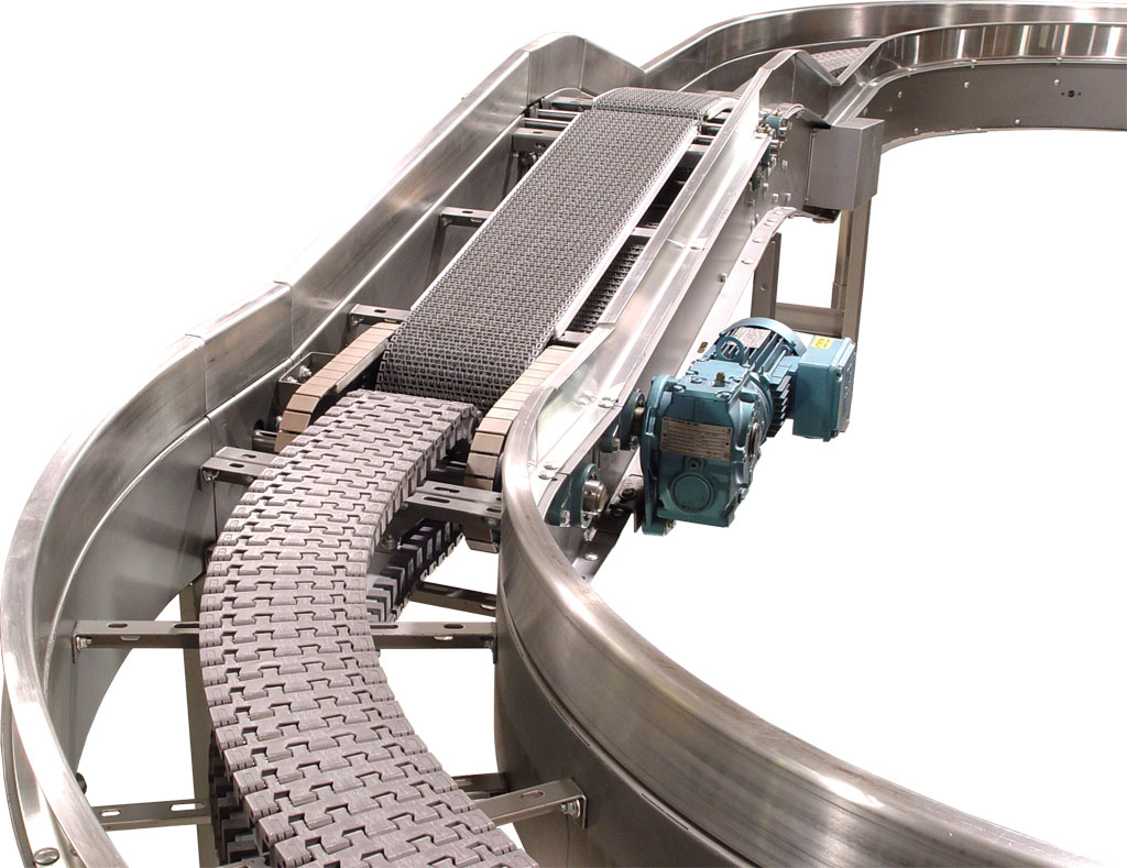

This is a Zone Touch case conveyor from Container Handling Systems Corp. (CHSC), which uses chain drives that function as accumulating sections. It has longer life than conventional machines with rollers and fabric belts. It’s also quieter than roller conveyors because its tabletop chain rides low-friction UHMW wear strips and return ways.
Common versions are single-pitch attachment chain, double-pitch attachment chain, hollow-pin chain, curved-attachment chain and plastic-sleeve chain. The attachments let engineers put special fixtures or blocks onto the chain to serve specific conveyor functions.

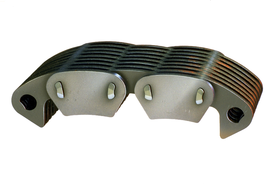

Morse inverted-tooth chain drives from Power Transmission Solutions of Regal-Beloit America comes in HV versions for high capacity at high speed. Silent chain is another option to make smooth, silent drives at slower speeds.

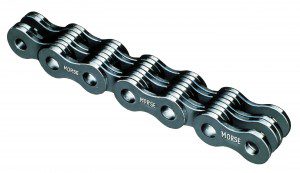

This Morse leaf chain from Power Transmission Solutions of Regal-Beloit America is made of roller-chain-type links and riveted pins for maximum strength for a given width. It works as tension linkage or a lifting device at slow speeds.
