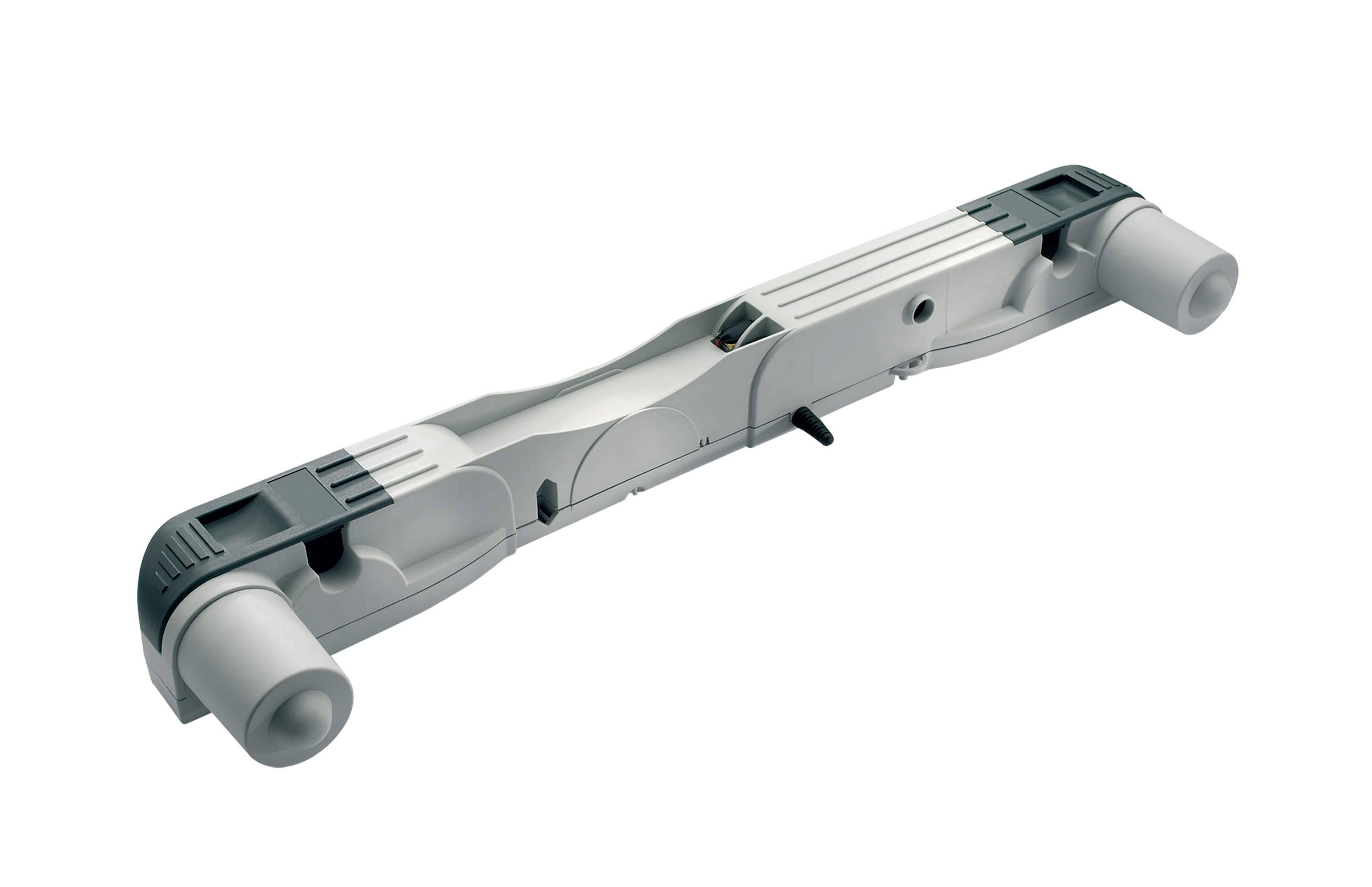

The LINAK TD1 220 and TD1 250 dual actuators have a low built-in height with hidden motors. Maximum torque is 220/250 Nm.
The LINAK TD1 220 and TD1 250 dual actuators have a low built-in height with hidden motors. Maximum torque is 220 or 250 Nm.
