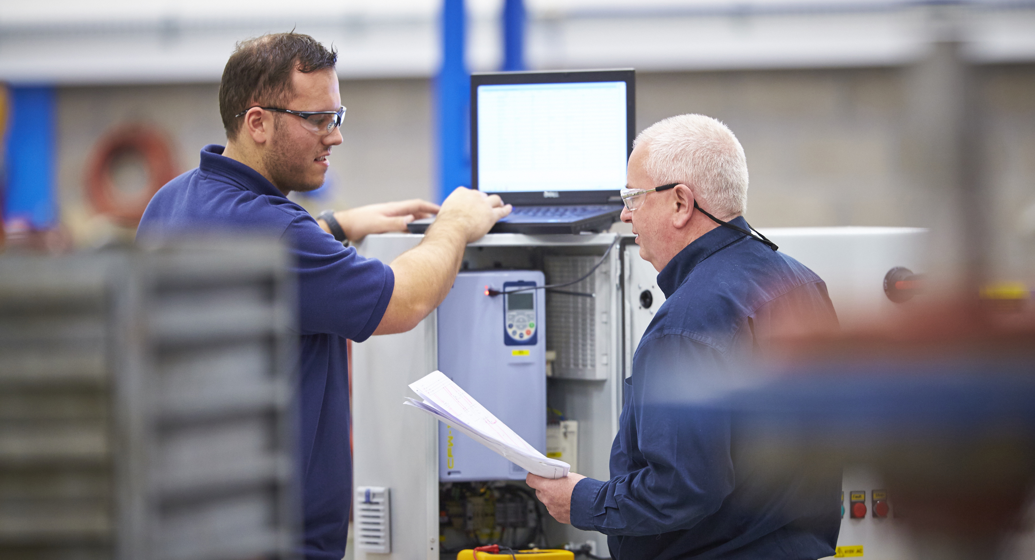

Periodic inspections include analyzing error codes and inspecting electrolytic capacitors and printed circuit boards (PCBs). There are also insulation resistance tests, fan and ventilation checks and using thermography to identify any loose connections or overheating components. In addition, the control program should be checked and also saved to an external location allowing it to be reloaded onto a new drive in the event of a catastrophic failure.
Diagnosis at the installation to determine the cause of VFD issues
In situations where a drive has failed, on-site diagnosis is crucial in order to determine the cause of the failure and to assess to most effective solution. Often the customer, and more specifically the operator, can provide vital information that can be used in conjunction with the error code information to establish the root cause of the failure. A thorough assessment will determine if the repair can be made on-site or if the drive needs to be taken back to the service center.
Often, the controls are operational. It’s usually the power side that fails, as this has to perform the majority of the work.
