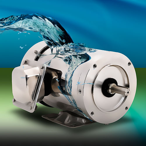

AutomationDirect’s IronHorse™ general purpose AC motor line includes stainless steel three-phase motors available in horsepower ranges from 0.33 to 2 hp. Motors are available in speeds of 1800 and 3600 RPM and are electrically reversible.
IronHorse-stainless-steel
The three-phase industrial duty 56C-frame TEFC motors feature 304 stainless steel frames and stainless steel shafts. IP56-rated, they are equipped with a large easy-to-wire junction box with fluorinated silicone rubber gasket and stainless steel cable gland. These NEMA design B motors are available with or without mounting feet and can be mounted in any orientation, horizontal or vertical, as long as the drain plugs are installed in the two lower locations. The stainless steel series is CSA-certified, and is designed for washdown applications as well as being ideal for applications such as conveyors, fans, gear reducers, and pumps.
