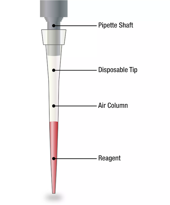

Inside an air displacement pipette, for example, a piston creates positive or negative air pressure that allows a user to take in or eject a liquid sample using a disposable tip. Meanwhile, the tip’s air column separates the liquid from the non-disposable part of the pipette. Pipettes can either be designed to allow the operator to trigger the movement of the piston using a thumb button, or a motor can move the piston when an operator presses a button.
Used in molecular biology and analytical chemistry as well as in many medical tests, electronic pipettes allow for accurate and repeatable delivery of samples and reagents. These electronic units have become increasingly common among researchers compared to manual types. When an operator uses a manual pipette over a long period of time, the pipette may become uncomfortable or even cause injuries. For example, the force required to dispense the liquid and eject the pipette tip, combined with repetitive motion for hours at a time, can increase the risk of repetitive strain injuries (RSI) in a user’s thumbs, elbows, wrists or shoulders.
By contrast, electronic or motorized pipettes offer better ergonomics, as well as a more efficient way to increase sample throughput with precision and accuracy. Instead of the traditional thumb-controlled pipetting button and manual volume adjustment, electronic pipettes have a digital interface that allows users to adjust the volume. The motorized piston is used for aspiration and dispensing.
A diagram of an air displacement pipette shows the major components including the air column and a reagent sample.
