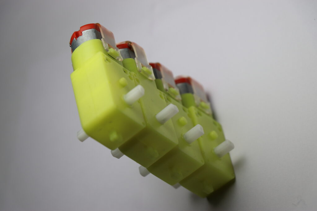

Miniature and microgearing with high precision and tight tolerances is used to deliver accurate low-backlash power transmission complementing small electric motors in:
• Medical devices and surgical tools
• Aerospace rovers and satellites
• Small motorized electronics.
Such gearing is most often paired with small dc motors that is either brushed or brushless — with coreless permanent-magnet motor types increasingly common in these applications.

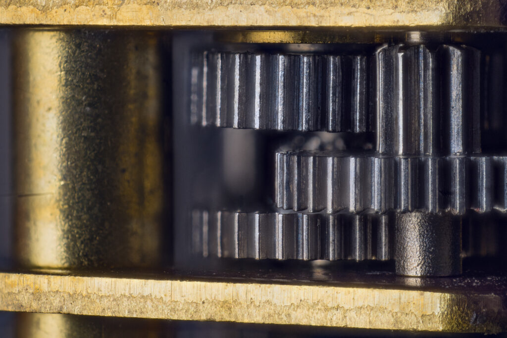

Consider a specific haptic application — that of electronic fly-by-wire flight control. In these systems, a pilot’s steering movements aren’t transferred via conventional mechanical or hydraulic actuators. Instead, electronic transmission occurs via force -feedback feeling through the motor assembly in a joystick control column. Such haptics-generating motor-driven designs benefit from miniature gearing capable smooth backdrivability and simultaneously generating torque and force based on joystick position.
Gear arrangements in these and other miniature and microdesigns are often customized with specialty mounting geometries, tooth profiles, diameters, and integrated sensing or other components.
What’s more, such miniature gears are usually constructed from high-strength materials to maintain overall design compactness. Subcomponents of stainless steel, titanium, and specialized plastics and composites are common where the gearing is destined to be implanted in the human body due to these materials’ corrosion resistance and biocompatibility; for the latter, additional surface treatments are sometimes applied to gear housings to discourage bacterial growth. Gears made of noncorrosive materials are often customized by component suppliers using precision molding and machining capabilities in controlled settings to satisfy FDA medical-manufacturing requirements.
