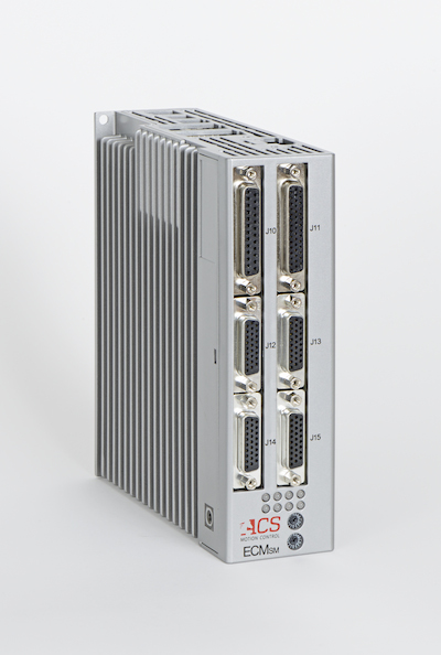

The ECMsm from ACS Motion is a 2- or 4-axis motion controller with integrated drives supporting up to 3.3/10 A per axis and a 12 to 48 Vdc drive supply input. The compact footprint makes it suitable for small-format equipment in biomedical and semiconductor applications.
