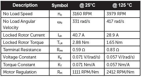

Estimated Motor Characteristics at an Elevated Temperature of 125°C
Increased Terminal Resistance
Rmt(f)  = Rmt(i) x [1 + αconductor (Ѳf – Ѳi)]
Rmt(f)  =  0.59Ω x [1 + 0.0040 (125°C – 25°C)]
Rmt(f)  =  0.83Ω
Decreased Torque and Voltage Constant (K used for both KE and KT assuming SI units)
K(f)  =  K(i) x [1 + αmagnet (Ѳf – Ѳi)]
K(f)  =  0.071 V/rad/s x [1 + (-0.0020)(125°C – 25°C)]
K(f)  =  0.057 V/rad/s or Nm/A
Decreased Locked Rotor (Stall) Current
ILR = VT / Rmt(f)
ILR = 24V / 0.83Ω
ILR = 28.92A
Decreased Locked Rotor (Stall) Torque
TLR = ILR x KT(f)
TLR = 28.92A x 0.057Nm/A
TLR = 1.65Nm
Increased No Load Speed
n0 = 9.5493 x [(VT – I0 x Rmt(f)) / KE(f)]
n0 = 9.5493 x [(24V – 0.30A x 0.83 Ω) / 0.057V/rad/s]
n0 = 3979 RPM
Increased Motor Regulation
Rm = n0 / TLR
Rm = 3979 RPM / 1.65 Nm
Rm = 2412 RPM / Nm

Maximum output power @ 25°C
Pmax(i) = 0.25 x ω0 x TLR
Pmax(i)  = 0.25 x 331 rad/s x 2.88 Nm
Pmax(i)  = 238 W
Maximum output power @ 125°C
Pmax(f) = 0.25 x ω0 x TLR
Pmax(f)  = 0.25 x 417 rad/s x 1.65 Nm
Pmax(f)  = 172 W
The maximum power at the elevated temperature is approximately 70% of the maximum power at room temperature.  This is a significant change, and it’s a direct consequence of the increased motor resistance.  Equation 6c will give results that are within 1 or 2% of the numbers above.  This equation is helpful in rapidly estimating the maximum power capability of any DC motor.

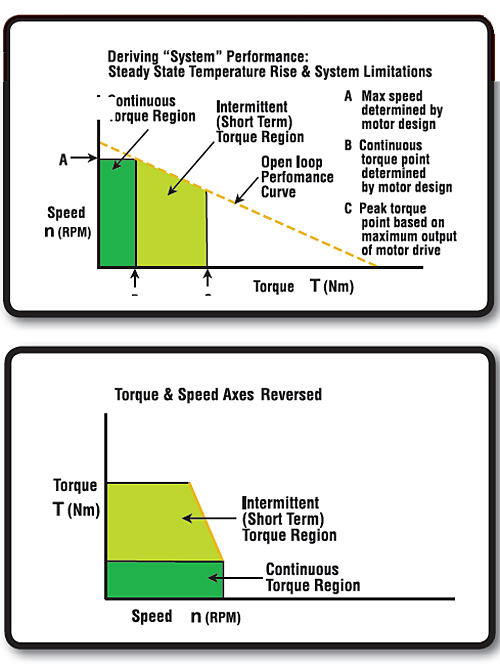

An example motor curve removes all other variables and assumes the motor is tested with a fixed terminal voltage using a low impedance power supply and progressively loaded with a dynamometer. The test is performed as quickly as possible to minimize motor temperature rise.  If the motor being tested is a small sub-fractional horsepower motor, the dynamometer may load the motor until shaft speed hits zero or close to zero RPM.  In the case of larger motors, the dynamometer may be set to progressively load the motor to approximately the maximum power point.  The remainder of the curve may then be extrapolated.   The resulting data in either case are (theoretically) straight-line speed versus torque and current versus torque curves.
Some manufacturers, in particular those that supply complete servo systems, may present performance curves as a “blend” of information that includes system-level limitations. The limitations considered can include many things such as continuous current capability, peak current capability, drive/amplifier power limitations, maximum DC bus voltage, maximum motor temperature ratings, motor saturation, and mechanical speed limitations.  Many manufacturers may illustrate motor torque on the “Y” axis and speed on the “X” axis.  The example curves in Figure 4 illustrate how data might look if factors such as maximum rotational speed, maximum temperature rise, and peak drive current are considered.  No matter how the data is published or what other system factors are considered, the motor parameters Rmt, KT, and KE are critical for understanding the true capabilities of the motor.
torque-and-speed-axes
Fig. 4: These example curves show how data might look if factors such as maximum rotational speed, maximum temperature rise, and peak drive current are considered.
Another factor to keep in mind when evaluating various performance curves is that actual test conditions may not always be obvious.  Different suppliers will publish different information.  In the case where the motors are tested rapidly on a dynamometer (to minimize temperature rise), this method tends to be very consistent and provides a good baseline.  The disadvantage is that the results don’t represent worst case conditions.
