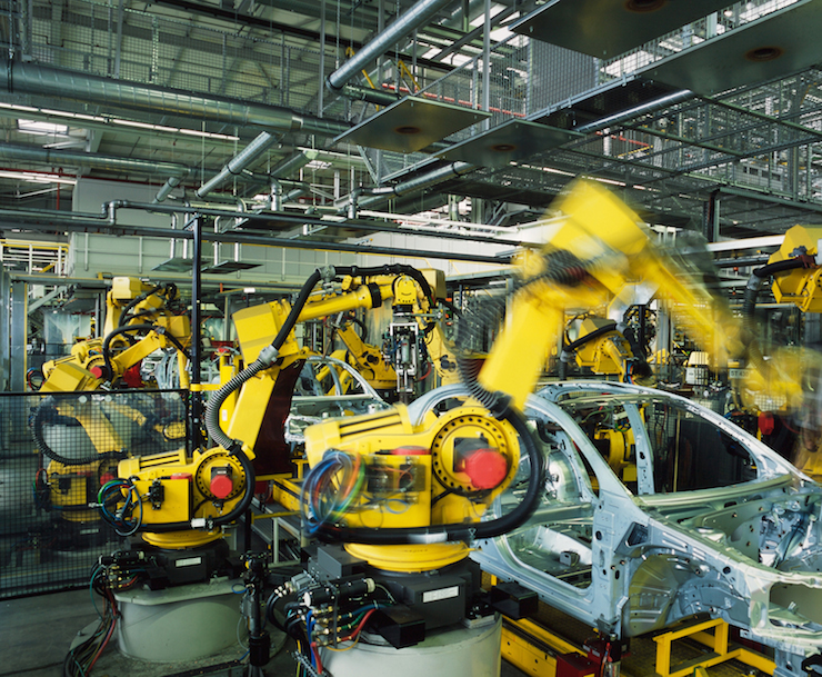

Today’s manufacturing plants use robots and conveying systems to increase their efficiency. Automotive assembly plants especially benefit from new conveying technologies, helping to save time and increase throughput.
