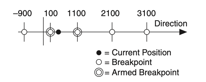

Some controllers also offer advanced breakpoint functions, such as buffered breakpoints and periodic breakpoints. A buffered breakpoint is simply an array of breakpoints that is pre-loaded into the motion controller, so that the next breakpoint is automatically set up once the preceding breakpoint is triggered. Periodic breakpoints are triggers that occur at exact, fixed intervals.
breakpoint
Periodic breakpoints require an initial breakpoint and a breakpoint period. Here, the initial breakpoint is at 100 counts, and the period is 1000.
Image credit: National Instruments

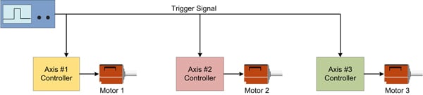

In a multi-axis system, a breakpoint can be triggered by one axis, while the event is an action on a different axis. For example, the trigger could be the status change of a limit switch on “axis 1,” and the resulting event could be a change to the motion profile of “axis 2.”
breakpoint
An external trigger can be used with a multi-axis system to create a synchronized event, such as a change in velocity, on all the axes.
Image credit: Performance Motion Devices
