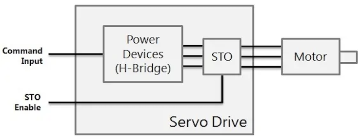

A block diagram shows the STO function within a servo drive. (Source: AMC)
In both cases (shutting off the motor and preventing an unexpected start), power to the motor is cut off and remains off. Electrically, the power (or current) source to the motor is cut off via circuitry within the drive, which does not affect any of the other drive functions. In effect, power is cut off to the gate circuitry that provides current to the motor and produces torque. So, the drive can remain connected to a power supply without the motor receiving any power.
