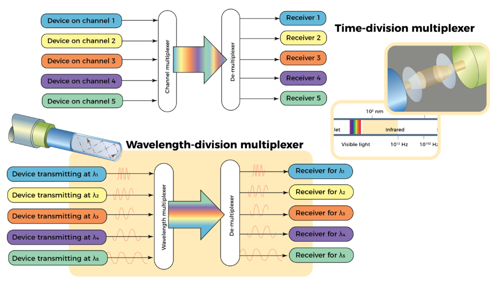

Fiber-optic slip rings often allow multiplexing or muxing — the transmission of multiple signals or data streams at one trace and at once. That allows for the full use of the optical lines’ high speed. Systems combining signals often use time-division multiplexers, which gives each independent signal a time window at an output. Other systems often use what’s called wavelength-division multiplexing — which gives each independent signal on the line a set light wavelength for transmission. This in turn boosts line capacity, speed, and scalability.

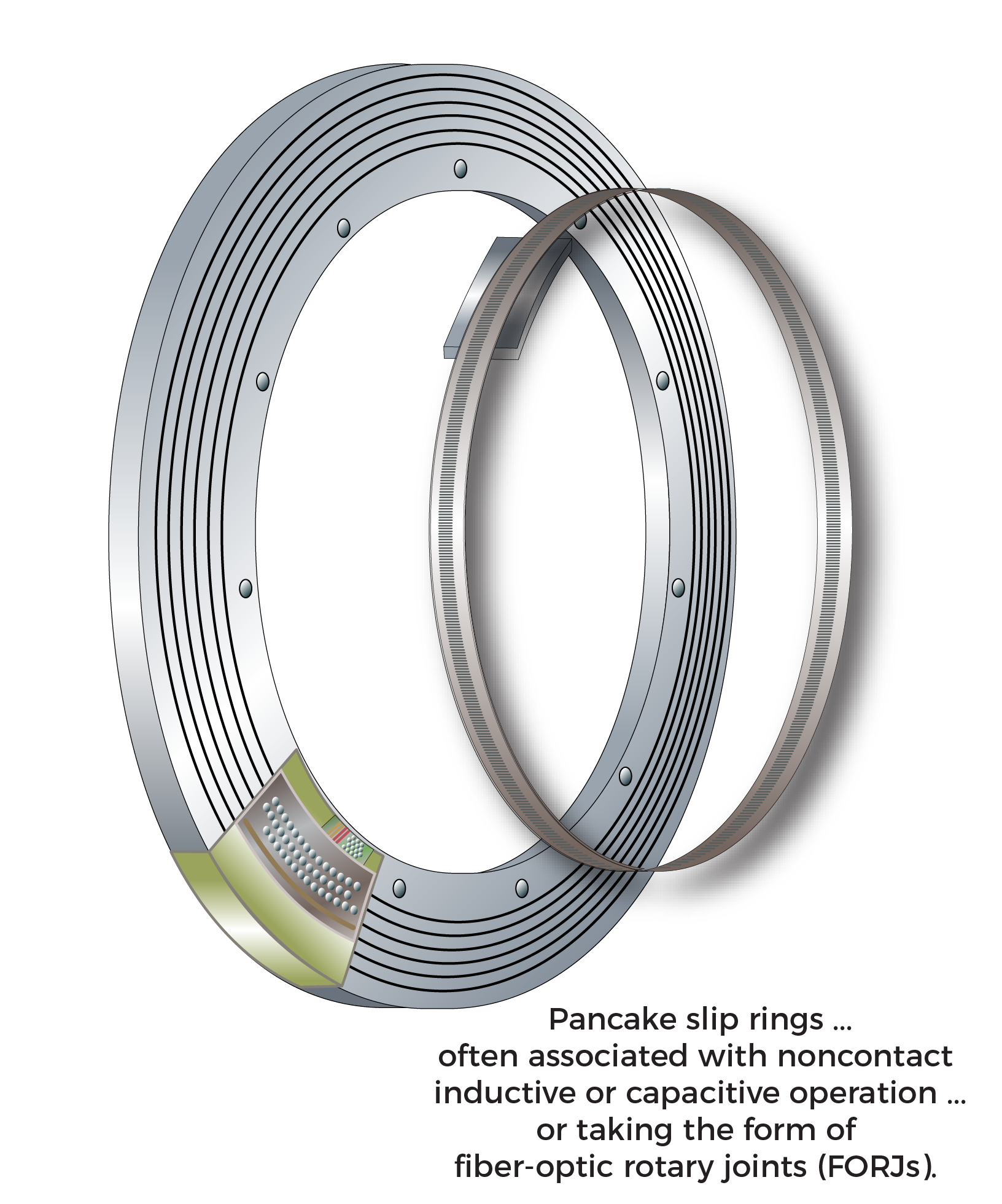

Pancake slip ring designs — common morphology for FORJs
Sometimes FORJs take the form of pancake slip rings — also called face slip rings or just flat slip rings. In this arrangement, the rings of the assembly are like tracks on a record. Using this analogy, the brushes ride the platter as a record-player needle. When discussing slip-ring morphology, the design we usually assume is the common drum design … not pancake slip rings. We usually take this morphology for granted.
Pancake slip rings based on contacting electromagnetic operation work for relatively low-current applications. They can be less power dense than comparable drum-shaped options — exhibiting more capacitance and crosstalk — and must be protected from debris on its working surface. Brushes are usually optimized for low height, but that can mean the brushes have little travel or exert relative light pressure on the rings. The outermost rings exhibit faster wear than inner rings, so can be the limiting factor on life. But pancake slip rings obviously have shorter axial lengths than traditional slip rings with a comparable number of circuits. No wonder that slip ring designs that incorporate both fiber-optic data transmission and other noncontact electromagnetic power transmission have pancake morphology.
