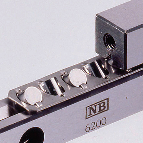

Metal and resin cages hold the rollers in different ways. Metal cages hold the rollers through a notch on the top and on the bottom of the rollers. However, the resin retainer fits around the roller. The resin retainer is able to harvest the whole shape to be held. The whole shape can be in contact with the load because the resin retainer exposes the necessary contact areas. It doesn’t compromise the contact area when holding the rollers.

four-rollers-in-metal-cage
