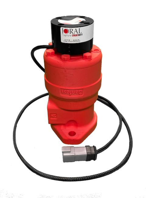

Joral LLC
Multiturn Position Sensor for Danfoss Hydraulic Motors – A Drop-In Motion Control Upgrade
Joral LLC’s motion control breakthrough is a multiturn absolute position sensor that mounts directly to Danfoss hydraulic motors equipped with the EMD (Electronic Motor Displacement) speed sensor pickup. By leveraging the existing mechanical interface, it converts a traditional speed sensor port into a high-resolution, multiturn position feedback system—unlocking advanced motion control capabilities without altering the motor housing.
Engineered for rugged mobile environments, the sensor is based on Joral’s proven non-contact absolute encoder technology, delivering power-independent multiturn tracking with no homing or battery backup required. Sealed to IP69K and resistant to shock, vibration, and fluid ingress, it is purpose-built for harsh-duty motion applications. Communication is available via CANopen or J1939, ensuring seamless integration with modern hydraulic controllers.
This drop-in upgrade enables true closed-loop motion control for hydraulic actuators—enabling functions like synchronized movement, real-time load positioning, and predictive diagnostics in mobile equipment.
What sets this solution apart is its simplicity: using the EMD pickup as a universal mount, Joral delivers advanced motion feedback with zero machining, zero programming complexity, and maximum reliability. It redefines what’s possible in mobile hydraulics—bringing motion control precision to an environment traditionally dominated by speed-only feedback.
