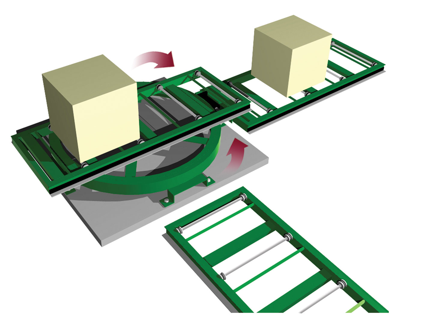

Shock-absorption technologies must withstand harsh environments that include extreme temperatures, caustic washdown areas, and high cycle rates. Shown here are shock absorbers on a turntable conveyor that increase handling forces while making motion smoother.
In addition, reciprocating equipment such as pumps and compressors with higher levels of vibration can be used in the manufacturing process without damage to bolts or adding heavy and inefficient structural braces. Adding vibration isolation can reduce this risk and boost pump and compressor performance.
