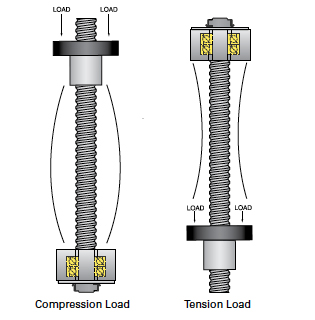

Ball screw back driving – Screws are often used in vertical applications because they prevent the load from catastrophically crashing if the motor loses power. But if the load is too heavy, it can still cause the screw to back drive. This application note provides equations for calculating back driving torque.
Ball screw buckling – When a screw is used in a vertical application, it’s important that the load doesn’t exceed the column strength of the screw, which depends on the screw length and the end bearings used. This tutorial explains why buckling occurs and how to calculate the buckling load for a given screw.
